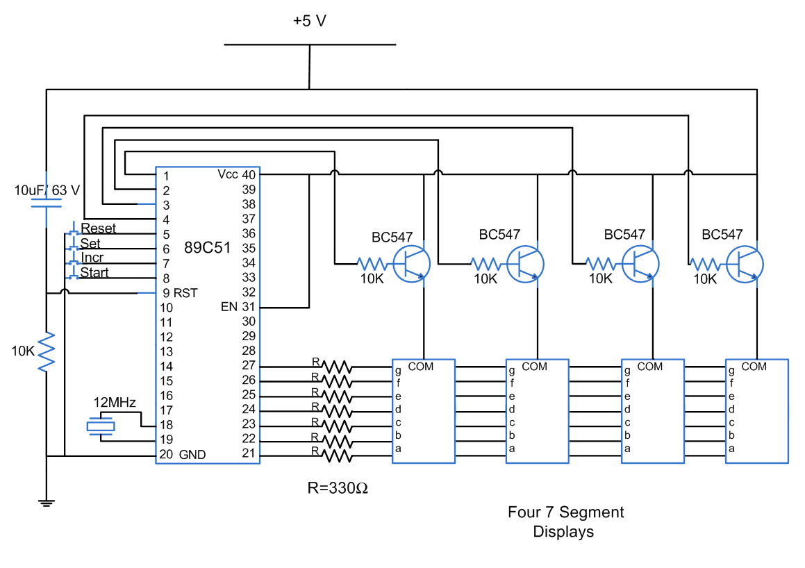

    This circuit diagram will help you out:
    RTC using 89c51
    If you have "MP and MC using Assembly programming & C" by A.mazidi .. open page no. 313 or 333.

    #-Link-Snipped-# has provided you the ready circuit diagram now its your turn to execute this before you are going to ask for ready code for the same.
    Start working on Circuit You can update your progress or problem here with us we will try to help you.
