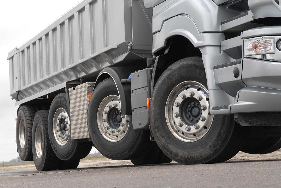

    @vikram-s-EgXevn • Dec 12, 2013
    The reason for more number of tyres at rear is to distribute the load & provide stability while driving uneven long distance.
    A vehicle having 6 wheels (2 front , 4 rear) can work with 4 tyres also (2f, 2r) but, will not get the balance to ride on the road. the two external tyres are used only to provide balance , grip & stability to the vehicle
    I'v observed in multiaxle trucks that during the full load condition they use all the tyres but after unloading they lift the pair of middle once.Multiaxle trucks .
