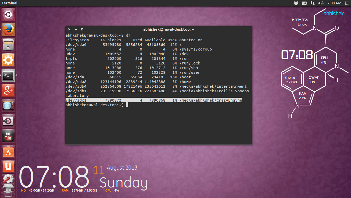

    @abhishek-fg9tRh • Aug 10, 2013
    Format Drive From Terminal :
    (We will format USB drive in this)
    - Insert USB drive in USB slot.
    - Open Terminal & type
     df
    - This will display directory path of various drives. Check image below :
    Screenshot from 2013-08-11 06:56:33
    The highlighted directory i.e /dev/sdc1 is the flash-drive which I wanna format.

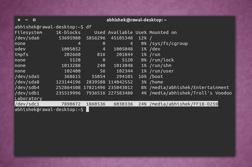

    - Type df again to check the result :
    Screenshot from 2013-08-11 07:08:05
