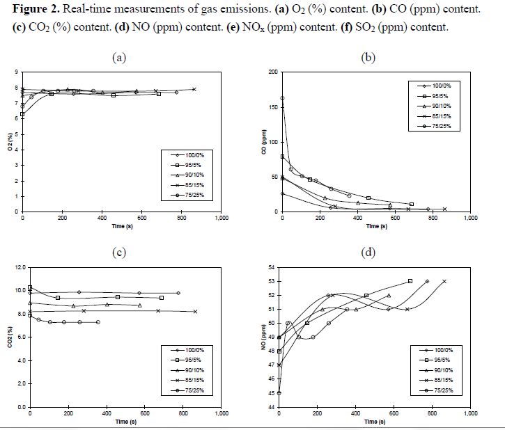

    Need suggestions.
    I saw some journals having graph for emission where it was plotted with CO vs Time.
    I want to know whether it is posdible to find it in this way or it can be found like load vs CO?
    Thanks in advance.
    @ramani-VR4O43 Mar 24, 2014
    Can you please post a link to the graph. Does not make sense to me. How can there be a variation of CO emission with time in a steady state situation?
    In an IC engine there could be variation between idling, steady running and acceleration/deceleration.

    gas emissioniS THIS GRAPH CORRECT?
    @ramani-VR4O43 Mar 25, 2014
    The X axis goes up to 1000 secs. Does this represent the ehaust of the IC engine or is this the exhaust of a steady state burning of the fuel in a burner?
    What do the percentages in the caption represent?
    CO2 and O2 becoming horizontal seems to be normal behaviour in a steady state situation. Drop in CO with time may be due to stabilization of combustion.
