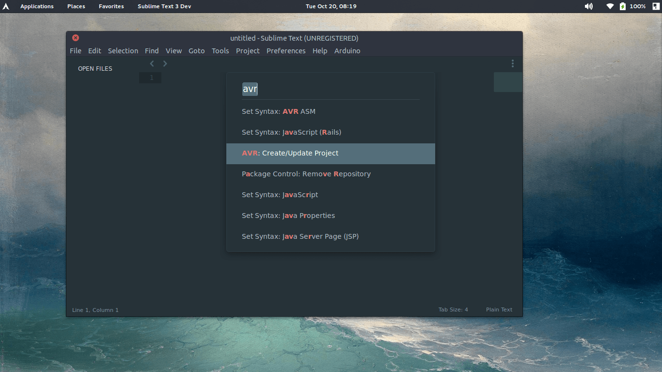

    Been working on hobby AVR project since couple of days, I was looking for a nice plugin for Atom or Sublime Text 3, and after lurking ST package control I found this awesome plugin named "AVR" that literally makes AVR development easier.

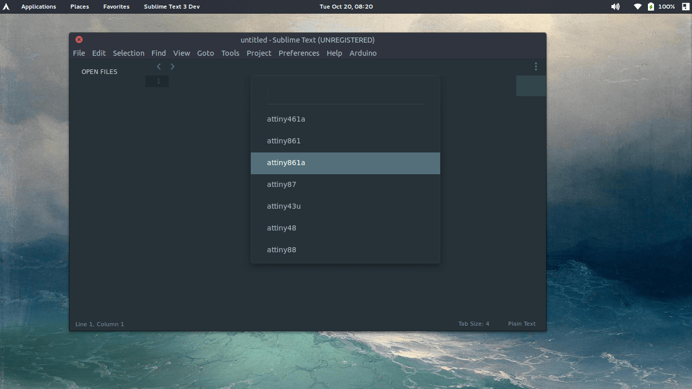

    - Select The AVR Project & Select the chip
    Screenshot from 2015-10-20 08-19-40 Screenshot from 2015-10-20 08-20-47

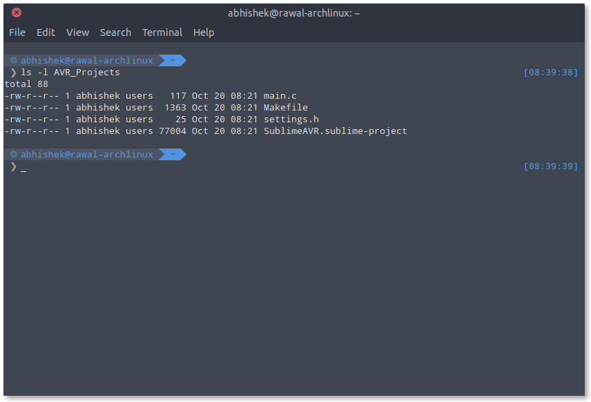

    - Select the directory and C template and makefile template will be generated.

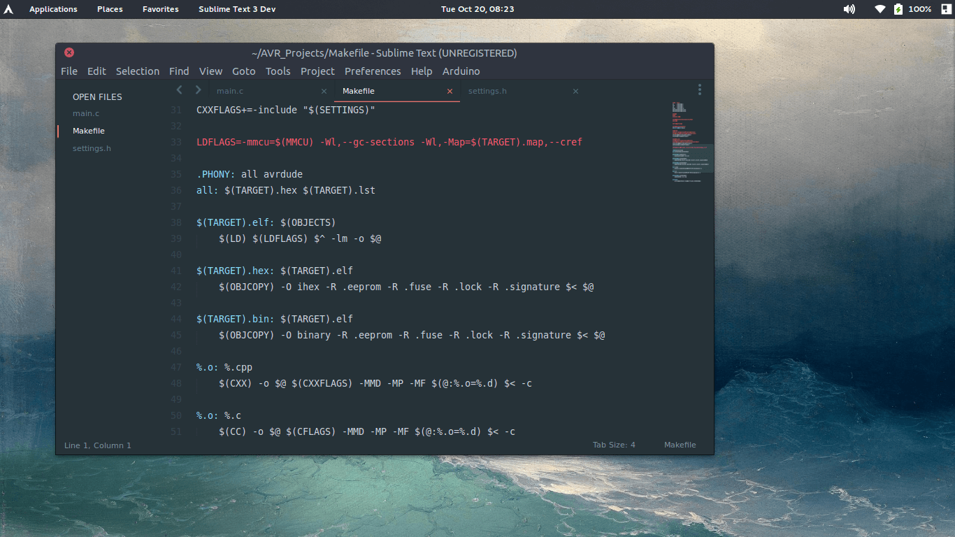

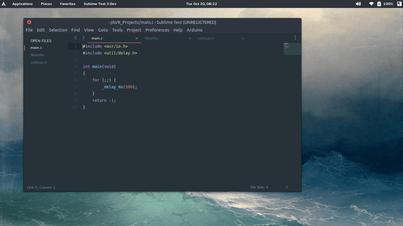

    Screenshot from 2015-10-20 08-22-58 Screenshot from 2015-10-20 08-23-12
    Write down your code and press ctrl+B, you can even change the compiler optimization level from Preference Settings of AVR package.
