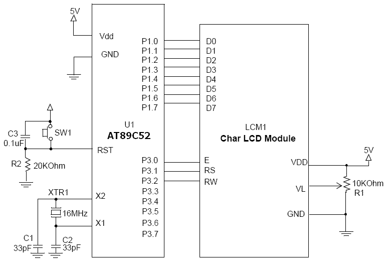

    Here is LCD Interfacing with 8051 Circuit diagram.
    LCD_8Bit Mode
