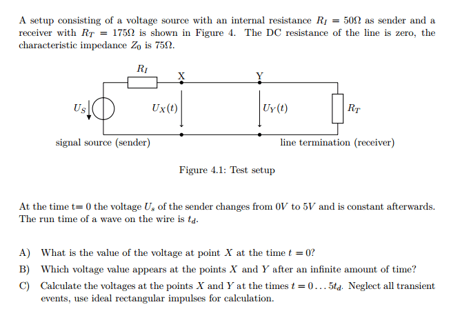

I need some description about the some Reflection of wires in communication. I have attached the Picture of My question Along with Answers for details so I shall be really grateful to you people if somebody spares his time to solve my problem.
My Questions:

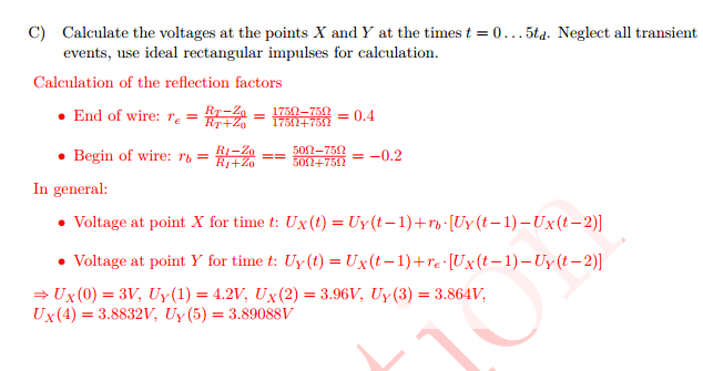

1- Can someone explain me why we have used Wave resistance in first part but not in 2nd part?What is condition to use it.
2- Can someone explain me please how he solved Part 3 as I need concept of it and I am not being able to get the whole concept.
3- What is concept of solving this type of question.
    The 'wave' only occurs at t=0. At t>0 there is no 'wave' because the sender V=constant=5, so the 'wave resistance' also only occurs at t=0.
    Use the 'wave resistance' only at TIME when a wave is present.
