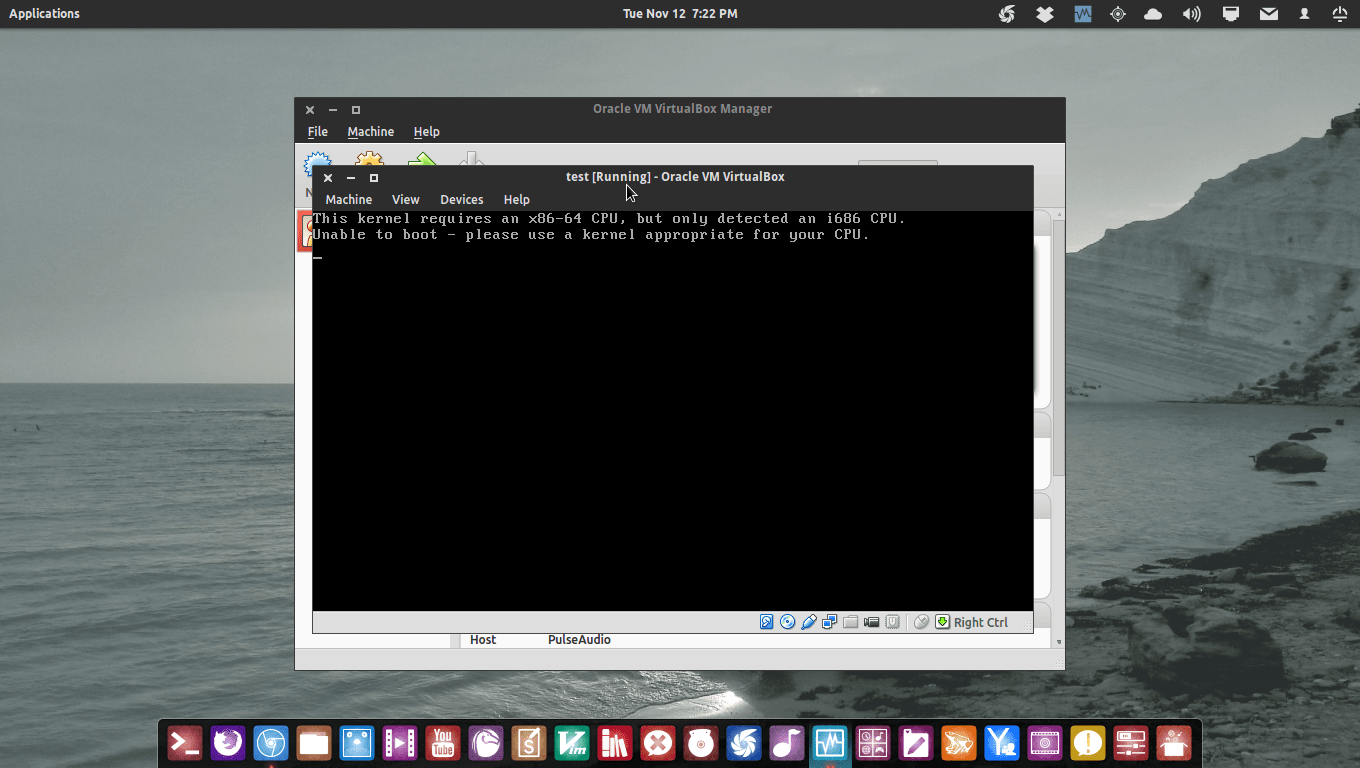

I am using 64 bit system, I have installed latest VMware & while I mount image & try to install any 64-bit, it gives me error as below :
Screenshot from 2013-11-12 19:22:43
Need to fix this asap. Please help ๐Ÿ˜€
    @abhishek-fg9tRh • Nov 12, 2013
    Update :
    uname -a says I am using 64-bit kernel too

    @aadit-kapoor-EBxnXT • Nov 12, 2013
    Which linux distro are you using?
    Aadit KapoorWhich linux distro are you using?
    eOS .. But ArchLinux as primary, because it's way too ahead than any distro out [HASHTAG]#personalopinion[/HASHTAG]

    @anoop-kumar-GDGRCn • Nov 12, 2013
    Was the error due to 32 bit kernel on Host OS and you ware trying to install 64 bit virtual machine?
    @#-Link-Snipped-# I was using 64bit Kernel only (3.2), for some reason Virtualbox was not showing 64 bit versions of any distro in software.
    So, I installed latest vanilla Kernel (3.13 -rc), updated the modules under init.d, rebooted the system & now I am able to select & install 64bit version of any distro.
    I really can't figure out what was the real reason behind error : Kernel or virtualbox.
